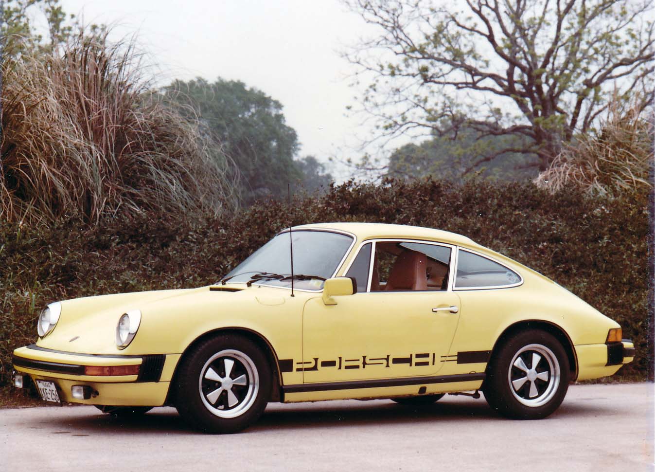

By the way Loren, what do they call that color yellow that your 911 was? My car is black now, but the original body color was this same color yellow. Down the road when I get it re-painted I'll return it to its original color.
