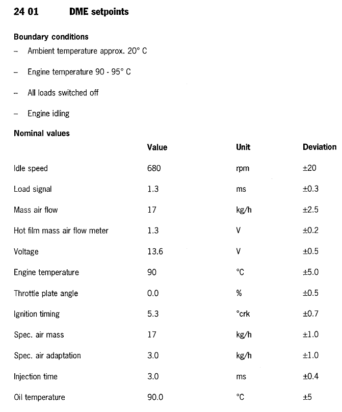

The 986 WSM states the following regarding warm idle rough running acceptable values. (unfortunately my copy of the wsm for the 996 is missing this data - the scan of that page is bad).
Rough running threshold be near 6.3.
Deviation +/- 1.5 (1/s squared)
Rough running shoudl be near 0.
Does anyone have the acceptable values from the DME for a 1999 996 3.4L?
This is related to timing correct? I can't find a good definition for rough running.
Thanks in advance.
72k miles. Here's what I logged in Durametric.
