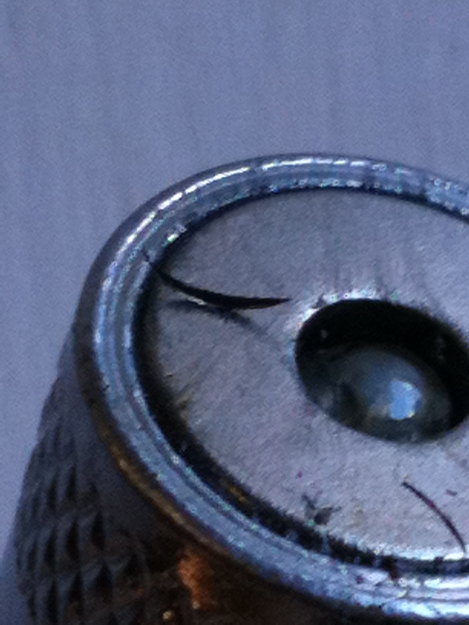

Just inspected oil filter after an oil change & noted three small (2mm) slivers of metal, in the shape of a fingernail clipping (thin, small curved crescent). My magnet picked them out of the filter.
Has anyone seen any debris like this? I'm wondering if they ate shavings off a bearing (IMS) or possibly even part of a thread off a screw (?!). Apon closer inspection, the crescent shaped flakes are very thin & the largest has a very slight lip on its outer edge of the curve.

Since this could be an IMS bearing issue, I'd take these clippings to your favorite P-car aftermarket shop for their opinion. I'd stop using the car until this was resolved. Applause is in order for your investigative attitude towards your car.
You need to find out what metal the flakes are, as that will tell you where they came from. I would pull the pan and see what you find down there as well.
Either way,metal that size in an engine is never good. I absolutely would not drive the car until you figure out what this is.
