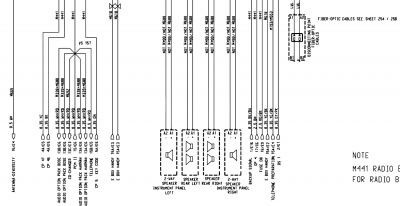

It did have a CDR-23. Since it was the base audio system with no amp or CD changer, nothing was connected to the MOST connection (Connector G). I have a feeling that the alarm info might be transmitted through the CAN bus (Connector C - yellow).
