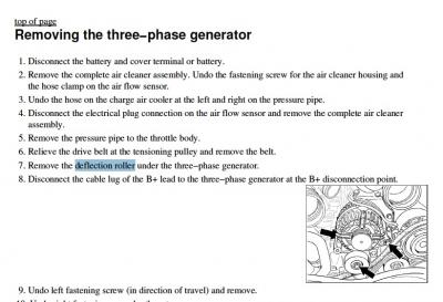

Sorry ,never done it but in the repair manual page 643 you got the generator removal and the deflection roller is part of the job.... Hope this help....

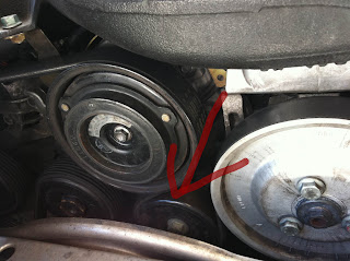

Thanks but its the other deflection roller next to the AC Generator so further down the big metal engine carrier. I guess I'll find out on sunday...
Share this post
Ok, I can confirm that you cannot take that deflection roller out with the engine in place. The engne carrier is obstructing the srew, not much missing but not enough. I've added some lube and new srew-lock and the noise is gone for the moment...question is how long.

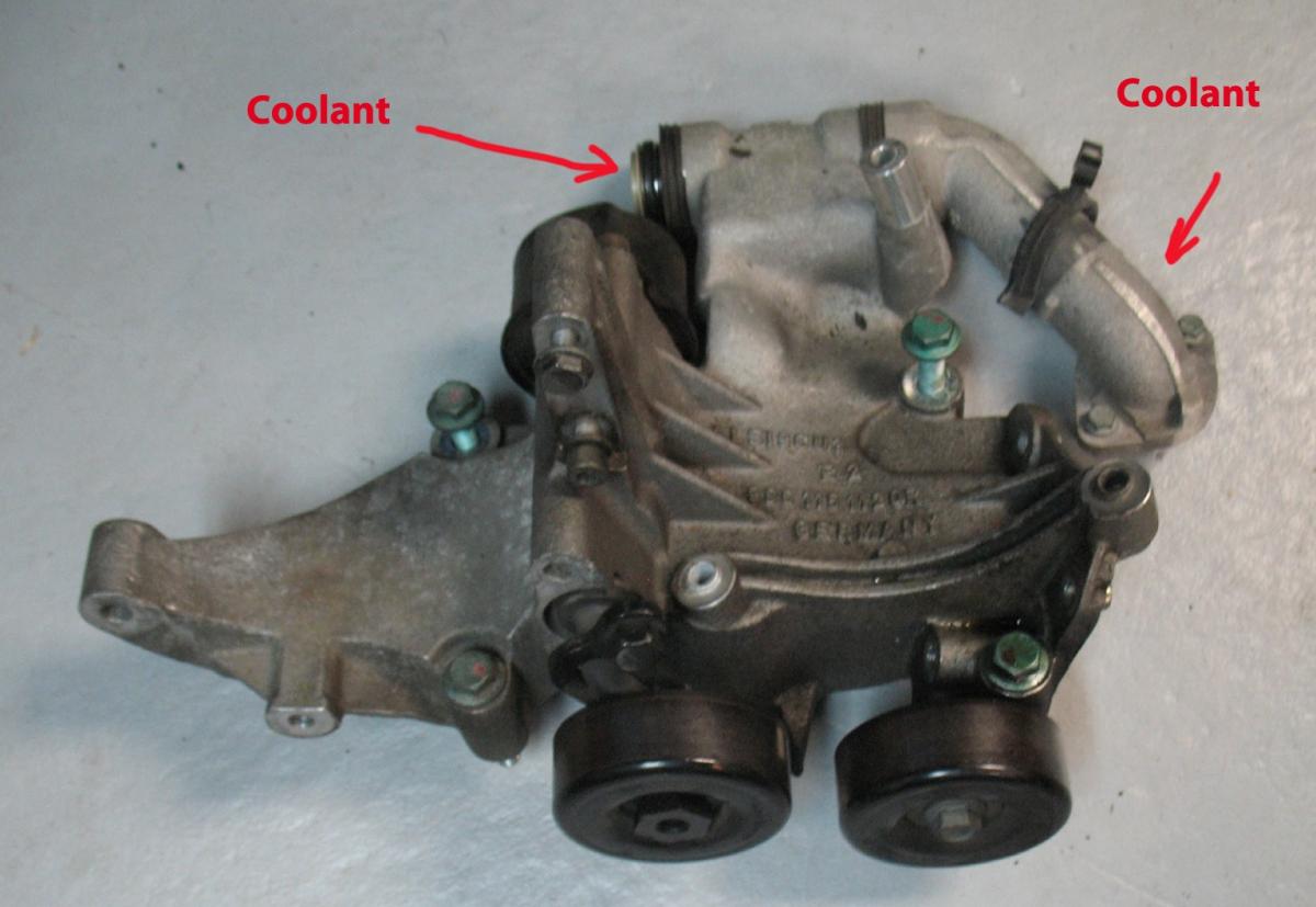

I need to replace the same idler roller on my turbo. Did you ever manage to remove the bolt and pulley without moving the engine?
Share this post
Fedmax was not able to take it out because the bolt is touching the engine carrier. But the engine carrier can be remove with the engine in place see repair manual for water pump removal page 529. And if the bolt is still too long you have to take the generator bracket out of the car and it is a big job but, of course, it can be done. Everything is in the repair manual , start at page 646. Just took mine off about two weeks ago. But my engine is out, and it is in fact a good job. You have to drain the coolant and remove one of the elbow in front etc....

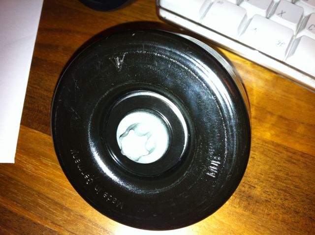

Thanks for the insight and good to know that it works. One thing that stopped me from trying was the new deflection roller has a torx rather than a normal wench screw. Was that the same in your case? Did you just use the old screw? Here are the pictures:
