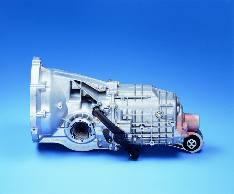

If you have recently had RMS problem fixed or transmission work then check and see that they hooked the wires back up to the switch on the transmission. If not, then check the wires from the transmission switch and if they are okay then replace the switch on the transmission.
Your reverse light switch is either not hooked up (as was said previously) or its inop/busted. Replacement is fairly quick and easy. Location as noted in Loren's pic. Switch is about 9.00 --- 99660610301...but check that p/n just to be sure...
