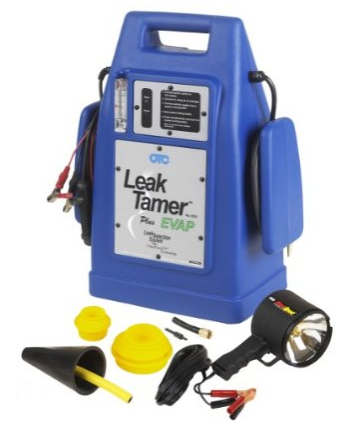

Problem is a pin sized hole is almost impossible to see with a smoke machine.
