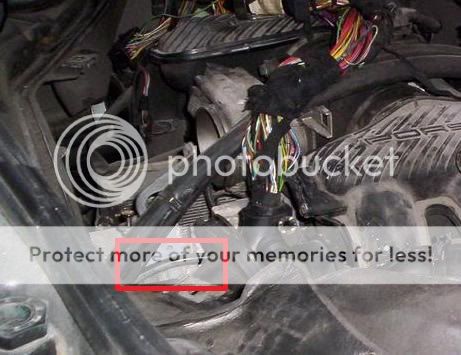

  1. When disassembling I managed to slip with the wrench and crack the hard black tube that runs just to the right of the throttle body (as you face the engine). It appears that there is a cable inside. What is this and what does it do? I put it back together with duct tape for now, I'll wait for final reassembly of the engine compartment trim until I hear back from one of you.

This Boxster lives outside and it's raining... so I grabbed this pic from the internet. Not a great angle, I can get a shot of mine tomorrow. It's hard plastic tubing with a cable? inside. It starts somewhere near where the coolant reservoir comes through the trunk. I'm thinking oil dipstick. Hmmm. Easy enough to test in the morning.
FYI - after driving about 20 miles tonight the idle settled down and is as steady as ever at 780 rpms.
