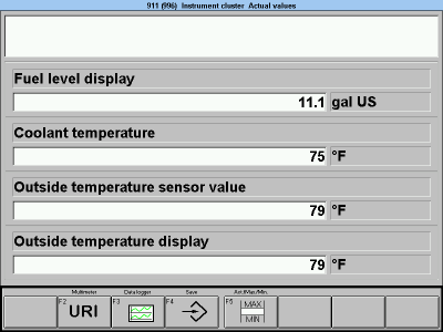

So the DME reports 97C which is certainly not overheating. Did you also connect Durametric to the instrument cluster module to see what temperature it reports?
If the coolant level sensor was disconnected and the light is still flashing at 105C then my guess would be that the instrument cluster thinks the car is overheating or the or DME thinks the purge fan is not running.
I'm starting to run out of ideas too.
The Durametric 6 will not read the instrument cluster that I could find and Loren confirmed it. I hate to take it to our dealer. My 89 yr old Mother just fell and hit her head. This is common. I will be watching though. Anybody with any idea accepted. Loren, you're usually good on the hard ones. Where are you?

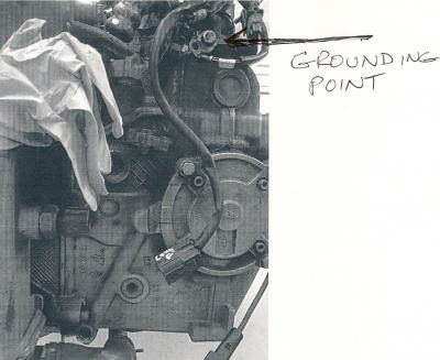

post-55687-0-53008000-1316751656_thumb.j.jpg]Does anyone know what the grounding point is for in this photo? It is on the passenger side towards rear of car. It is right above what I believe is the oil pump. When I was chking the coolant temp. sender I can see this grounding point which has a bunch of oil and dirt on it. It is kind of hard to get to but might be related to my problem. Thanks, Robert. Edited by ALLSPEED
If I remember right that is a ground point for bank 1 of cylinders (1-3) spark, fuel, etc. It is possible that the water temp sensor shares that ground... even if it is dirty and adding resistance, I'm not sure it would be enough to throw that light??? You might be onto something though with a wiring problem if it is not the sensor.
