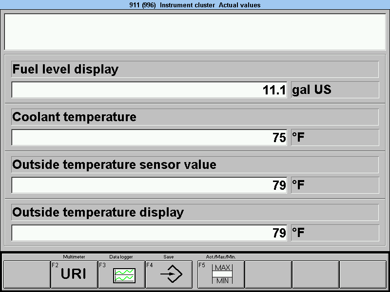

Durametric is correct ( I setup my Durametric on my MY1999 996).
The Instrument cluster (which shows the sensor at the coolant tank) does not display. BUT the DME does show the ECTS (Engine Coolant Temperature Sensor) - which should still help you determine if the coolant tank sensor is bad.
The ECTS should be pretty much dead on as the DME uses it. So I would see what it shows. In the end I'll bet you have a bad tank sensor.
BTW a PST2 can show both sensors (DME and Cluster).
post-1-0-46457600-1316467760_thumb.png post-1-0-62942500-1316467764_thumb.png
