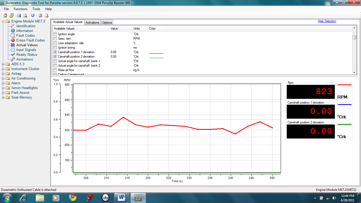

Here is a picture of my cam deviation post IMS bearing upgrade. Prior to the bearing replacement I had .60 degrees difference deviation between bank 1 and bank 2. Another improvement was the idle, it became smoother and it increased ~150 RPM.

Page 69 of Diagnosis to 45 for Boxster 986 says +/- 4 degrees. Interesting.
I think a couple of things changed; originally, the early five chain motors were +/- 4 degrees, and were pretty good at meeting and holding the range. The switch to the three chain design and the later VarioCam Plus seems to cause more cam deviation, so the value was moved. In reality, early or late motors seem to do just fine as long as they stay within the +/- 6 range, so a lot of dealers and shops started using that as the “default” range for everything.
