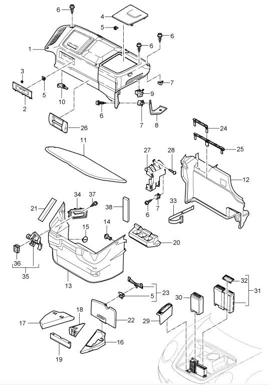

Loren, the part in question is not on the image. JK probably meant the two quick lock screws belonging to the lid of the tool kit/tire repair kit holder, which is located near the fire wall, on the bottom of the trunk, under part # 1 (997 C2/ 987). Is it possible that the tool kit illustration contains the needed parts?

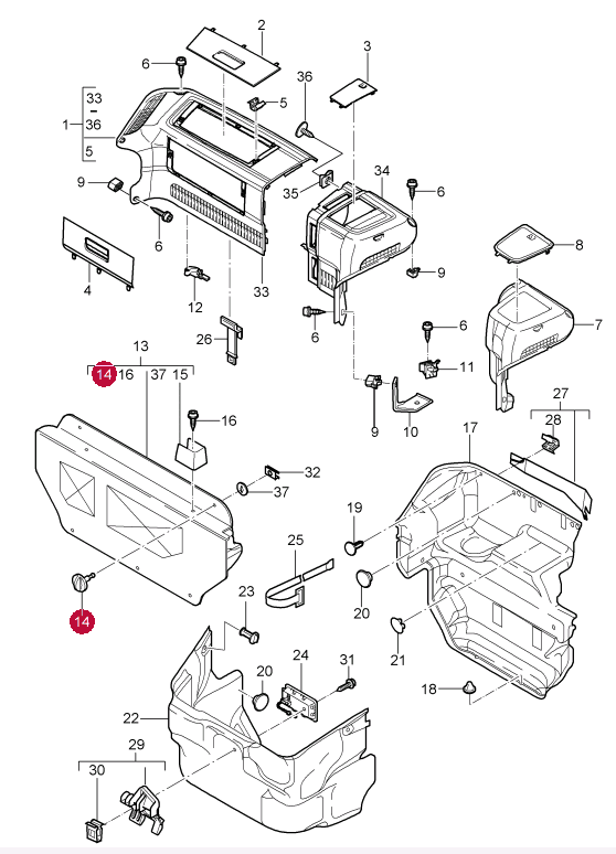

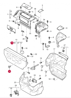

Thank you RFM and Loren. My attempt at describing the missing part certainly needed the improvement and accuracy provided by RFM. The two diagrams provided by Loren helped immensely. It looks like the #14 part as highlighted is what I need. You guys are great and the help is much appreciated.
