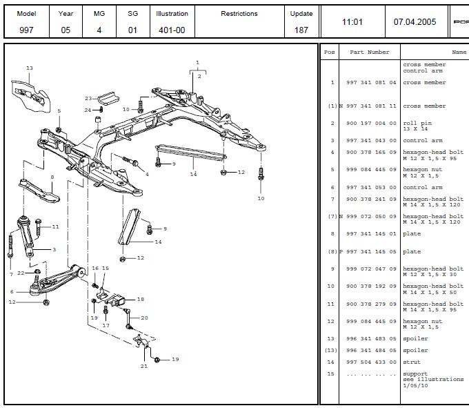

No, I'm referring to the crossmember (as it's labeled in the parts catalog). It is the large, H-shaped part that appears to bolt to the bottom of the frame, and all of the lower suspension bits connect to it.

I'm just wondering if there is any adjustment that can be done by unbolting it, moving it and re-installing it, or if it has no adjustment and therefore must actually be bent/damaged. If anybody has pictures of this part of the suspension, that would be useful, too. I haven't actually been under there to look at it, yet.

The cross member is mounted on fixed points, there are no slot holes for the bolts provided. A small shift of max. 1mm is maybe possible but not obvious. In extreme cases, after checking whether the monocoque and cross member are not crooked or damaged, the mounting holes on top of the strut can be a little milled out so that slot holes be obtained in order to achieve the specified camber values as such. It must be said that this course of action can only be applied when the differences are minimal and if nothing is damaged. It can be a solution for people who want a perfect alignment comply with the specifications, although it is far more important to have the camber on equal values on both sides even though they are a bit off of the specified specifications. Hope that your question is be answered to your satisfaction.
