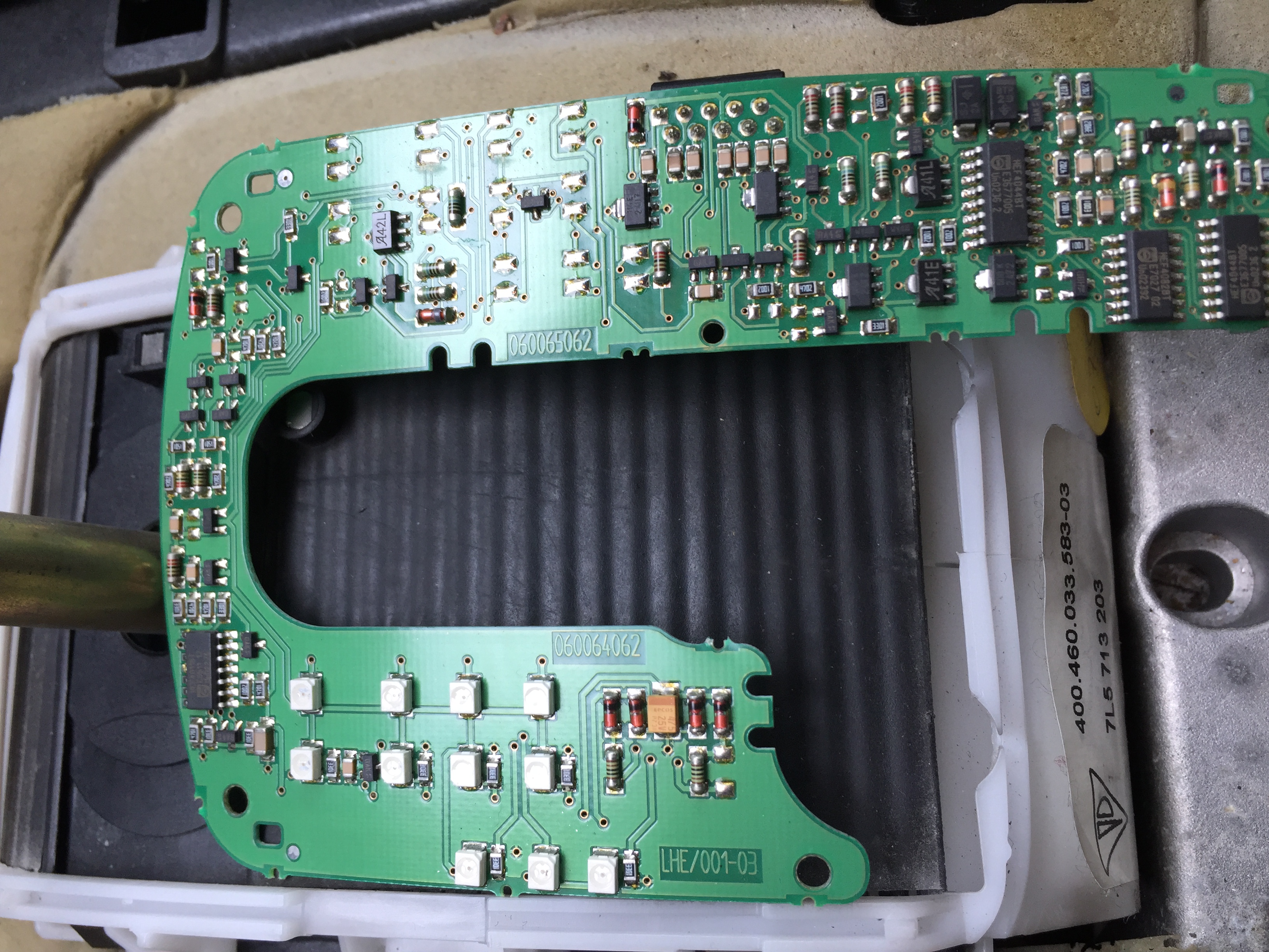

i disconnected the gear selector to check what is going on there. I couldnt find any broken parts. Magnets are still in place.
so what it can be?
what is found out, when i am taking away the circuit board and putting the selector in P it works.  Dont show message on the display any the key is coming out with a click how it must be.
what could be the problem?
I just went through this after a penny fell into my shifter assembly. I found this and replaced the "sunshade" (the black rubber part with the magnets) and it works fine again now. http://www.pelicanparts.com/techarticles/Porsche-Cayenne/11-BODY-Shift_Gate_Trim_Replacement/11-BODY-Shift_Gate_Trim_Replacement.htm#Customer_Comments_Bookmark It is part #95555226500 for the 955's. Not sure if it changed for later models or not. Mine didn't seem to be broken, but it sure didn't work properly. I think it may only take a little bit for the magnets to get out of line with the circuit board and that is how it senses what position it "should be" in.
Also make sure you get the circuit board snapped back into the plastic liner above it securely. Otherwise it's going to droop down and get hung up on the magnets.

Thank you guys for your advice. Very welcome. About the black rubber part with the magnets i was thinking to because it was mentionend in a Pelican DIY. But it looked ok so i move on with my search. I will get a new one.

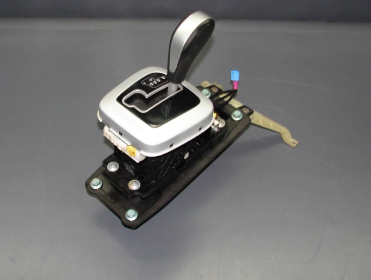

I am planning to change all the shifter assembly. Anybody did it? Something special i have to pay attention to? Anybody know if there is a adaption neccessary after that or this just drag and drop?! Thank you
I did the change of the complete shifting assembly but ended up not it; thus I have an assembly for sell if anyone interested in it!
There is no need for any adaptation but just drop and play. My case it was the corrosion of the wires I fixed the last then fixed all the issue including the key not release and the manual shifting issue.

Please help. Dont want to destroy my shifter knob again by doing something wrong. I read a lot of post on different places. Still not shure if to proceed this job with shifter in "D" or in "N".
posts are confusing. What is the save way to do it?
