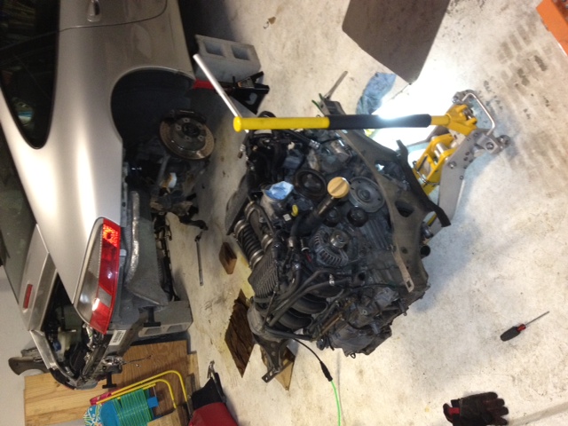

Have had both heads repaired for cracks in the spark plug recess of cylinder 1 and cylinder 6. after removing spark plug tubes no evidence of visible cracks like before. Diagnosis still unknown.
Plan to remove heads again send to machine shop for presssure testing, and look at block for evidence of damage/cracks.

Could you be more descriptive as to where the cylinder heads were cracked. I don't think that would case a intermix problem from what you are saying and I have never heard of a fault between the spark plug recess.
Both heads were resurfaced during last repair
Head gasket for 1-3 head looks good (just removed)
Pistons/combustion chambers 1-3 look good
Can AOS cause intermix?
Had oil cooler replaced prior to last head repair but am sending it in to machine shop for pressure testing
Cracks were visible to the eye extending from spark plug recess #1 toward the valve spring adjacent to it
