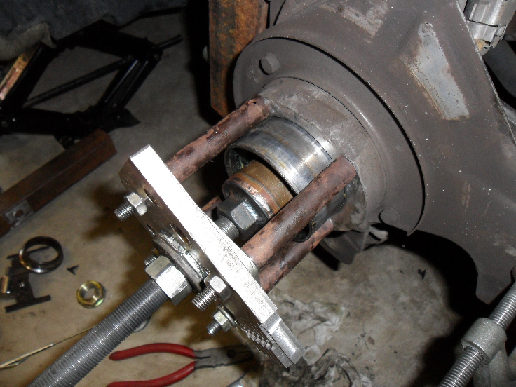

We do a lot of bearing work (see Casper Labs IMS bearing in forum). On the wheel bearing I replaced last week, a special puller was made that lets you leave the 1/2 shaft and/or stub axle in place!! No axle removal, no suspension disassembly. Old bearing out/new bearing in in 30 min. (for average wrench twister). Only drawback to the tool is that it is specific to one size bearing. For example, the Boxster S bearing is larger, and will require 2 different parts.
We have a pic of the prototype tool, but I have't the time at the moment to figure out how to attach it. Any one who wants to see it... just email me (N1WR@juno.com). We have material ordered to make a few production tools, to see if anyone is interested.
Bill Ryan
Here is the prototype puller with the bearing just about out. It is rough looking, but the production tool will be professional grade. This is a very robust puller, and will pull hundreds of bearings if used properly. Don't ask to see the mechanism, we will not tell you. Sorry, if you want to see how it works ...you will have to buy it

post-77241-0-97083100-1333550109_thumb.j

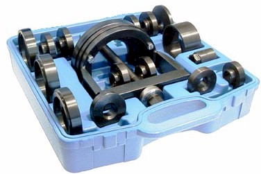

Thanks Loren, The B90 is a very popular tool with the Porsche community,.... high quality. BUT, we have taken it one step further by eliminating the need to pull axles/hubs/compress and partially remove front struts to get the old bearing out and new one in (req'd with the B90). This will save the amateur mechanic about 4 hours (pro...at least 2hrs) on a front bearing,.... with no need for additional tools (spring compressors, joint separators, etc.). The B90 is usable on different make cars. Our first tool will work on base 996/986 front and rear wheel bearings (exact same bearing). This same bearing is also used on some Audi's and BMW's, so we will have to look at the design of these cars to see if the geometry permits application. For a shop working these car models, it can add a lot of productive manhours. Our ugly prototype was drawn on CAD/machined on a lathe/mill/welded AND .....the bearing pulled in less than 4 hours. Production version will be very user friendly, made from 4130 chrome moly and 52100 bearing steel, and "pretty". Best of all, it will be half the price of the B90.
Note: It is never advisable to install new bearings by applying loads "thru the balls". The installation w/the new tool applies pressure on the OD race only.
BR

Here is the prototype puller with the bearing just about out. It is rough looking, but the production tool will be professional grade. This is a very robust puller, and will pull hundreds of bearings if used properly. Don't ask to see the mechanism, we will not tell you. Sorry, if you want to see how it works ...you will have to buy itBill Ryanattachicon.gifWHL BRG PULL.JPG

We sold a bunch of the production "no suspension dismantling required" bearing tools to various DIY mechanics. But the pro mechanics did not like the fact it pulled only the smaller bearings used in the Boxsters, and 996 front wheels. So,..... we redesigned it to pull both front and rear wheel bearings of Boxsters thru 04, and 996 thru 05. Now all configurations of these cars can be serviced with one tool (regardless of FWD, RWD, S model, or base model). You can see it on Ebay with a "Porsche wheel bearing puller" search. This tool is less than half the cost of a shop replacing just one wheel bearing!
