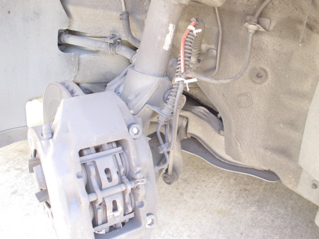

I try to answer based on the recent pad change on my GT3. The sensors (2, one inside pad, one outside pad) just slide into a groove machined into the pad backing plate. The pad wear sensors can certainly not be used, if that is being the case the sensors can be coiled up and secured to the underpinnings with a wire tie or such. Or they can be removed and a suto sensor can be made from an old sensor connector by twisting the wires together and inserting the adapter into the receiving plug.

My front sensors have been tied to the brake lines for a while as the rotors were getting close to the sensors. I am going to wear the pads down to the backing plate before I replace them.

I figured that I would never use my sensors, as I check the brake pads often, so I cut the wires down to about an inch, soldered them together, and put heat wrap over them. The brake light won't go off, it looks a lot cleaner than tying them up to the strut, and they don't get in the way of anything.
