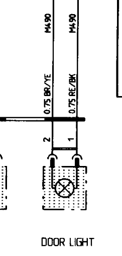

Finally got around to checking color codes of wiring to mystery connector. One wire is brown, the other is red with black stripe. I applied a momentary short across connector and drew a tiny spark.
