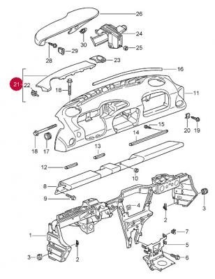

But, it is not the alarm cover, but the piece the alarm cover covers. Maybe that is what I should have said in the beginning.
Item 21?
See Item 23, I think that is the part you called the LED cover. It mounts onto a part which has the LED. I can't tell if it is the LED frame or something the LED part mounts into, which has this little tab, but the LED cover goes over this part and the part 21 which is the vent cover interlocks into in the center of the dash. I just looked again at the parts catalog again and the only part I could see being what I broke is 996.552.541.02, I assume 996.653.251.00 mounts in the the 996.552.541.02, but I can't tell. And, I can't tell at all which part has the LED. But, 996.552.541.02 is the only part that looks like it has the tab which I broke
I think your assumptions are correct. Looks like you need the light part (996.552.541.02)
Do you know if this is one piece which is the frame and the LED? And, how difficult is it to install?
Does anyone have a real picture of this part? I would hate to order it and find out it doesn't match what I need.
Again, Loren thanks for all your help.
Maybe this will help... (click on image to enlarge)
Loren, this is great, in pic 2, item 8 is the piece I believe I need. Looks like I will just need to take screws 7 out to replace this piece.
Was there in anything in pic 3 that would be helpful?
Thanks again.
