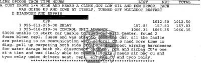

Attached is an image of the original problem / resolution I had on my 2006 Cayenne S. I got it back on the 19th of this month (last Thursday). Yesterday (7/25) the same problem happened (started but threw multiple errors on start up. I stopped the engine and it would not restart).
When I called the dealership, they agreed to have it towed. Although it hasn’t been diagnosed yet again, they did say that there must be more problems than the Tyco fuse and Airbag Control unit.

When my car first threw errors last week, but before the tow truck came, the car would sometimes start with no error codes whatsoever. If a Tyco fuse (pyrotechnically designed to trip in a accident) blows, why would I have been able to periodically run the car with no errors?
Does it make sense that I would have the exact same problem, even after a $1,000 USD part was replaced?
I do not have the original error codes.
I am just really worried it is going to be a $5,000 fix on top of my $2,200 original 'fix' ... and in the end, I will not feel comfortable that the car is reliable enough to drive to a customer's site, the grocery store or even take it on vacation.
