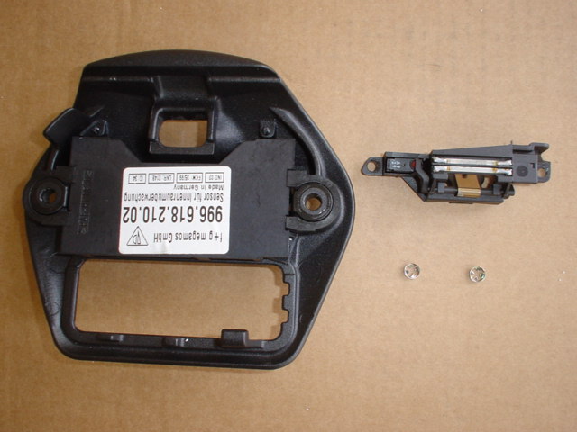

Pull out the 2 oval covers for the interior motion detector and behind them you will see 2 torx screws, remove the screws. Then pull the top latch housing away and disconnect the electrical connector.

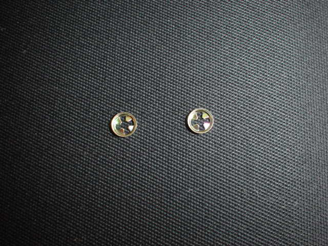

The switch is held in place with 2 round clips. Pry the clips off and then the switch comes off. You cannot reuse the clips so buy them when you buy the switch.
Or, the no cost way is to glue a shim to the button that gets pressed when the top is latched and see if that cures the issue.
Thanks for the photo. I thought of just gluing something on there, but it seemed so un-Porsche-like.
