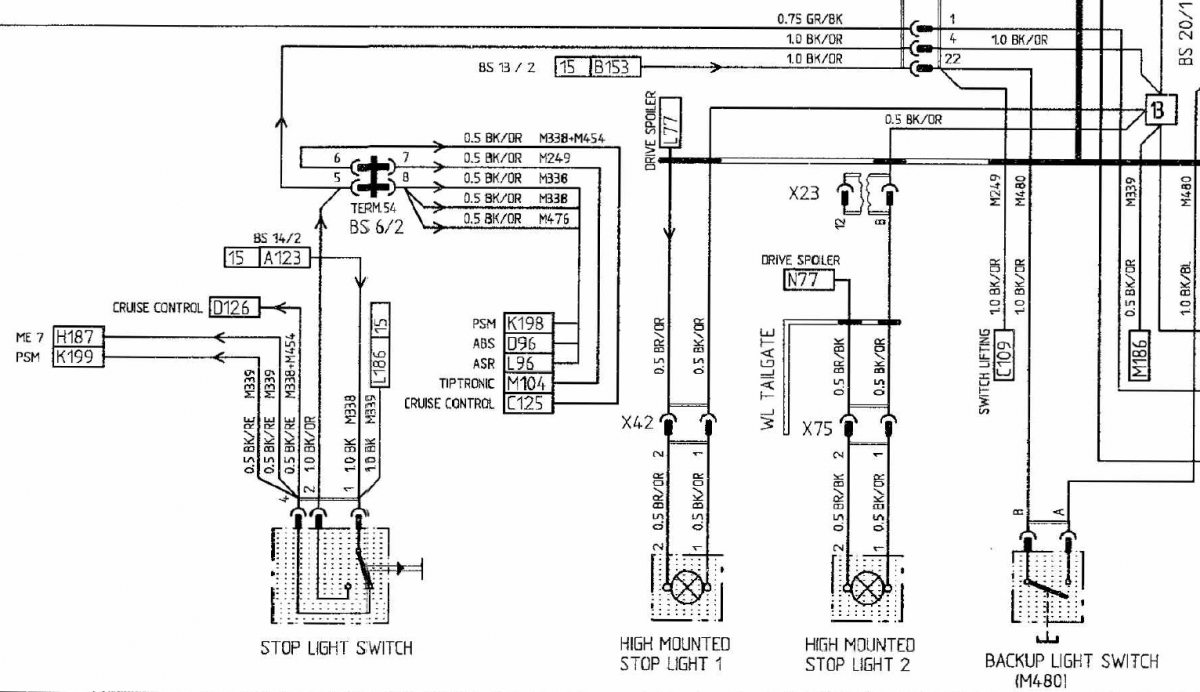

I have an issue with the 3rd brake light working intermittently,on a 99 C2 cab.
The pop up spoiler light works all the time when raised. However the light on the Clam shell doesn't wont work consistently, and seems to affect the cruise control as well. Is there a micro switch on the pop up spoiler that is bad and affecting the light on the clam shell?
If I open the Clam shell an inch by activating the top the light comes on,close it it goes out.

Thanks for the information, any tips on where to start looking? I have checked at the light itself and the the connector to the Clamshell assembly under the sound or heat insulation. the issue seems too predictable to be corrosion unless there is a contact block with exposed contacts.(like a slider contact on a minivan side door).
It seems to be related to the clamshell, as I mentioned raise the clam shell an inch light works.

Thanks for the tip, I just had the clam shell off when I replaced the Cabriolet cable assembly. The connections are solid on both ends. The problem is very predictable the last inch of travel when closing the light goes out.
The pop up spoiler light works all the time,do you a schematic on the circuit? there must be some interlock between the two lights.
