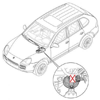

Removing the alarm siren
Preliminary Work
Remove the relay carrier in the plenum chamber E-box.
1. Unscrew fastening screw arrow 1 and pull the horn aside and upwards arrow.
post-1-0-14325900-1356098579.jpg2. Release the plug arrows A and pull it off arrow B.
Installation is the reverse - Tightening torque: 17 ftlb.
