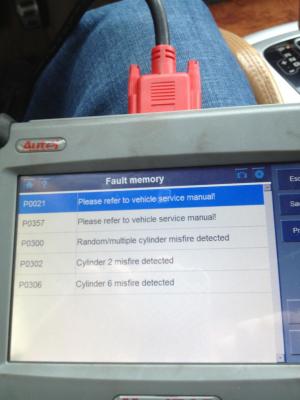

I have an 04' Cayenne S w/ 87K miles. Last month I had a couple of episodes of rough idle/running. (No check engine light.) After ruling out a bad tank of gas and the return of these episodes, I visited my indie mechanic. Scan results showed misfire cylinder 2/6. We replaced the ignition coils at 2 & 6 and cleared codes. Truck ran fine for four or five days and then the intermittent rough idle episodes started again. The second episode triggered the CEL (solid) light. Brought the car in today and the following codes showed:
P0357 & P0021
After clearing the codes, the rough idle returned and I rescanned. P0357 was persistent.
The original coils were replaced under warranty/recall by first owner. Plugs were changed at 65K miles. Wondering if it's time to simply change the remaining 6 coils, or if there are other suggestions?
