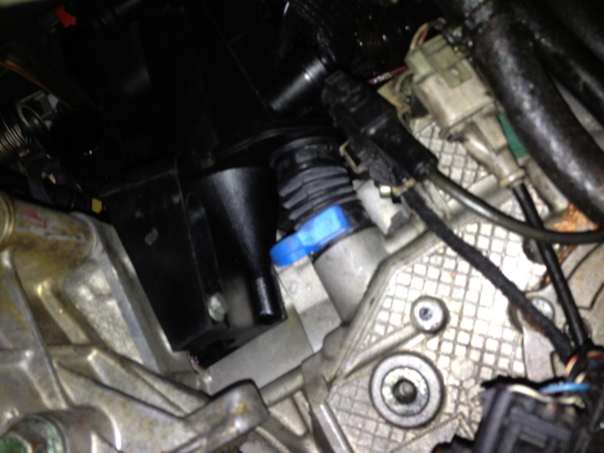

I removed my 2 year old AOS from my 1997 Boxster to replace the seal that goes between the AOS and the engine block.
Also ordered a new bellows, and 2 new clamps for the bellows, I ordered 1 top and 1 bottom clamp. The bottom clamp comes with a small plastic appauratus the holds the clamp open until removed. Makes changing the AOS much easier. The last time I changed my AOS and the bellows and clamps I did not get one of these. I clamped a small pair of vise grips to the clamp to hold it open...maybe they have been around for years...? anyway here's a picture.
post-31855-0-92027400-1358746550_thumb.j
post-31855-0-67722900-1358746649_thumb.j
When you order an AOS, it comes with the bellows and the clamp (w/ the blue contraption that holds it in the open position. I'm surprised your last AOS didn't come with the bellows.
Were you getting P codes associated with a torn bellows?
No, the seal for AOS to the block was leaking. I removed it to change the seal. Replaced the o rings in the j tube and decided to change the bellows as well.
