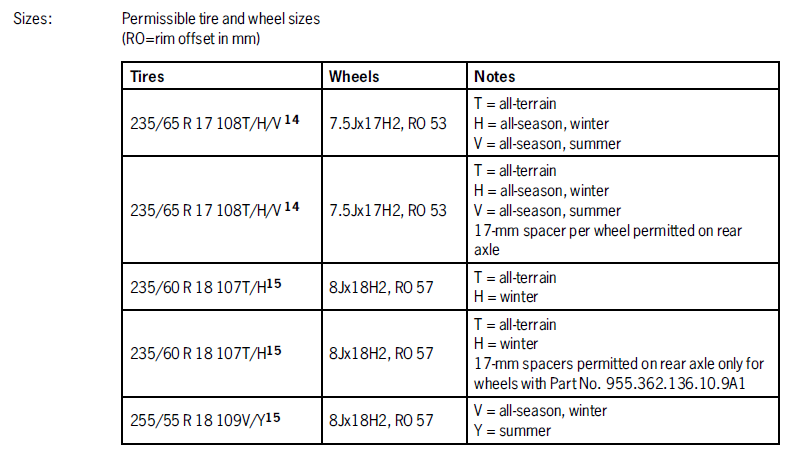

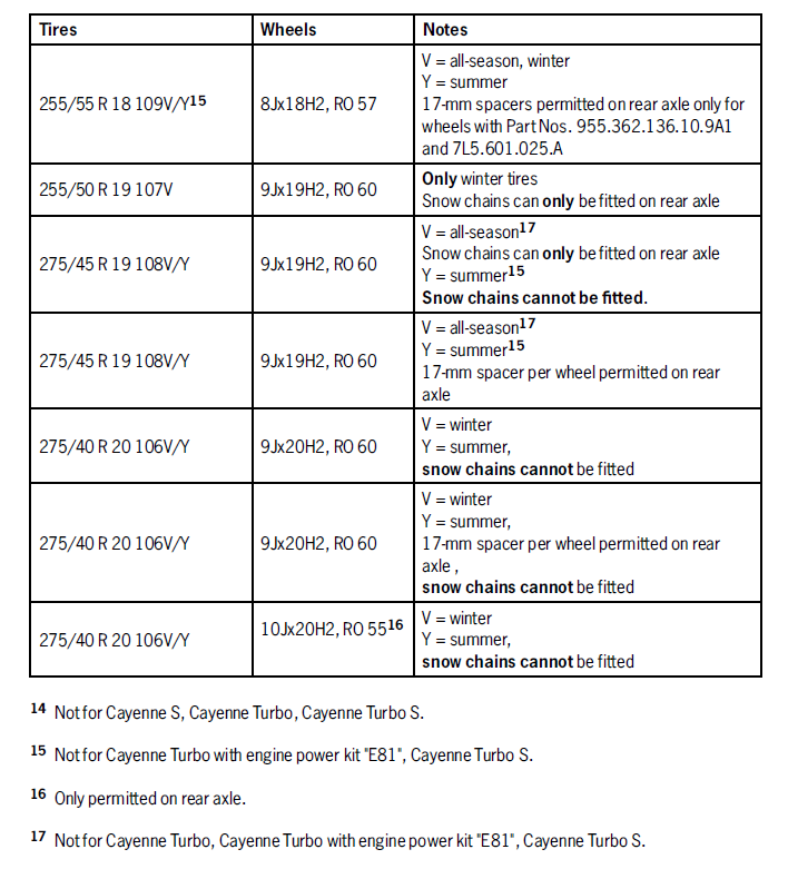

I live in India Loren and roads suckkk.....needed a wider tire, so an 18 inch would be good? I can use a 255 on an 18 inch? I'm getting a few 18 inch rims here but offset varies from 40mm to 55mm and width varies from 8 inches to 11 inches. Which one should I pick up?
