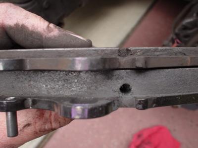

This is the hole on the front pads from a Boxster. The hole on the rear is identical.
Pagids don't have holes. I guaged the size of the hole off the stock pads by sticking in a drill bit and then drilled the pads to accept the sensors. However use super glue or silicone to secured the sensors to the backing plate as mine didn't hold and it marred the inside of my rim by the time I noticed it :(. It is just as easy to make a jumper off the old ones, especially if they're already wasted.
Strange, the oe gt3 pads have no holes for the sensors they just slip into a machined area on the pad backing plate and sort of sit just above the pad material itself. The front Pagids have the same machining but the rears are slotted like the picture with no hole in the pad material. So I've got the fronts functional and the rears tied up. But as I said I'd like to remove the rears and just use a by-pass plug.

As I had mentioned, strange. The OE GT3 pads have no holes and the sensors have no provision for using the holes if they were there. So I'm a bit confused, not all that unusual, but none the less, confused. The boxster S front pads are supposedly the same as the GT3 rears. I would have expected the sensors to be the same, given that information.
