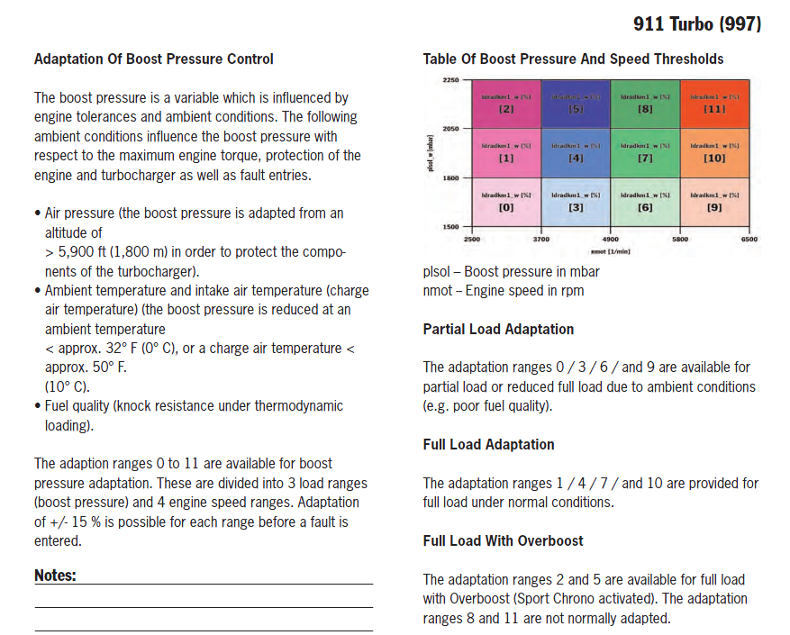

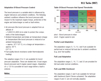

OK Loren, I need little help interpreting the ^ data.
Also not sure if that data answers my question though?
Question is: what should the stock boost guage in an '07 997 TT read, 0-6-14 or 0-9-18?
Btw, changed my member status, you guys are great.
I am not sure if the gauge readings change with adaption range. But if you look at the chart and the description of how it works their are 3 ranges - Partial Load, Full Load and Full Load with Overboost (SportChrono).
The adaption range changes depending on the mode the DME sees - so it seems you get max boost at lower RPM when in SportChrono (Overboost) mode.

post-70495-0-28094400-1367947062_thumb.j
post-70495-0-12855600-1367947070_thumb.j
