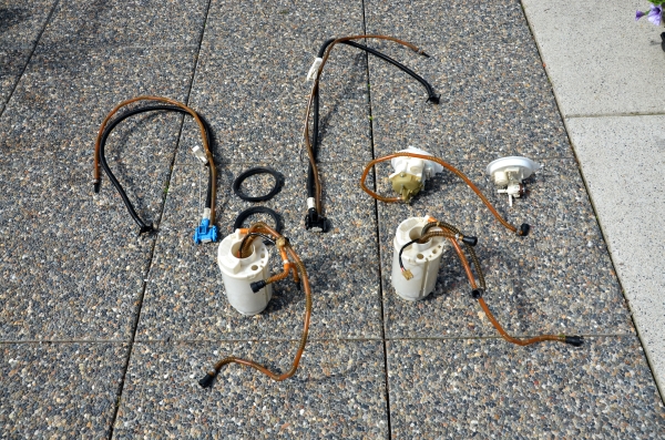

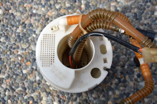

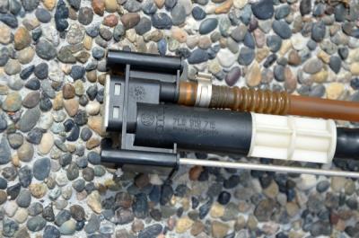

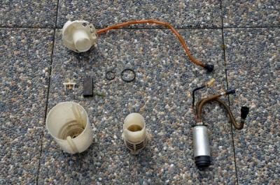

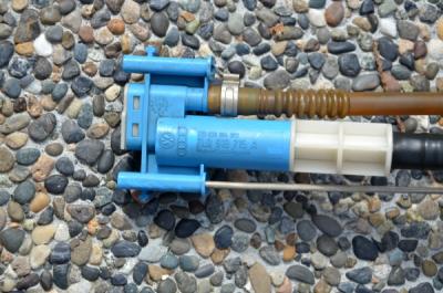

Anyways, it has two new pumps and other stuff like a new regulator and filter. The Cayenne now is more reliable before this service along with a new fuel filter. The following photos are of the parts I requested I get back from the dealership... a "unusual request" from a Porsche owner according to them. Well one pump was still working, right? Anyways, here are photos of the fuel pumps and other parts. Something that I would have liked to see ahead of time myself. I also dismantled a fuel pump assembly down to the motor and impeller itself. There is a CZ site that is selling the motor and impeller for about 105 Euro.
post-88071-0-16895500-1369383052_thumb.j
All Parts
post-88071-0-66513200-1369383058_thumb.j
Top of pump assembly... has VW stampped on top
post-88071-0-96246200-1369383065_thumb.j
Bottom of Venturi Tube... has VW and Audi circles
post-88071-0-00624900-1369383073_thumb.j
Venturi Tube, again VW and Audi
post-88071-0-08914200-1369383081_thumb.j
One fuel pump assembly... individual parts
post-88071-0-17002300-1369383089_thumb.j
The pump itself with side opening for impeller.
ps. After moving the impeller with a small screwdriver and applying 12 volts to the pump that was at fault, the motor spun up and ran. It did not run smoothly at its operating position (impeller end down), nor horizontally, but did ran smoothly "upside down". My guess is the bearings or bushing that bears the weight of the spinning parts of the motor itself are worn out. Suggestion to Porsche... make your fuel pump motors run in a horzontal position. But then no automobile is suppose to run forever... without maintenance. Since this incident was my first dealing with a Porsche dealership and seeing all the cars going in to the service bays, I pretty sure the dealship makes more money from servicing than selling Porsches... yep, I am new Porsche owner.
