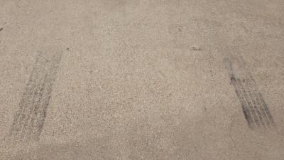

Silly question but what is the difference in the two rear ends? For example this Boxster S, if I'm going up my driveway slow and the clutch is popped it leaves two little skid marks equal length.

I guess but regardless how would it leave to skid marks. I've had open differentials in the past and only the right side would spin. Actually today when getting the front end aligned on the car I noticed while the rear wheels were trying to gain traction going onto the front end alignment lift, the right side was turning and then noticed the left side kick in too and spin. How would an open differential vary the drive wheel right to left or spin on both sides?
