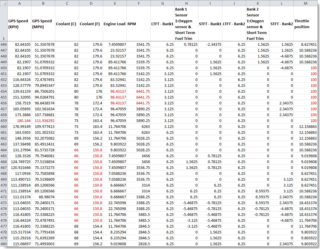

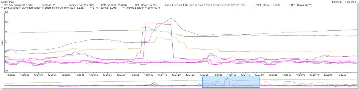

Thanks for the replies so far, guys. I was able to pull some data from Torque that shows this happening. I only made it up to 111 mph on this quick run, so the temp only dropped from 179 F to 150 F, but it's still noticeable in the data. Attached you'll find a screenshot of the raw data, a graph, and a ZIP file containing the whole spreadsheet of data. In the graph, the green line is coolant temp; the blue line is GPS speed; and the tall, flat purple line in the center is throttle position.
There are no unusual spikes (+/-) in the coolant temp's data (as seen in the overall zoomed-out view at the bottom of the graph), other than the one discussed here at high speed, so I find it hard to believe that it's a temperature sensor issue. Could it be the water pump, or maybe air in the coolant system?

While I have no experience with "Torque", the data is mystifying, the engine simply should not do this. That said, I note that all your coolant temps seem quite low for a car equipped with the OEM stat, which does not even begin to open until 186F, and usually is not fully open until around 205-210F. What kinds of temps do you get with this software during normal street driving? If they are as low ( or lower), there is something wrong with the thermostat.
I would suspect the thermostat, it could be bypassing coolant and the water pump is a positive displacement type so the increased volume at rpm might explain what's going on plus the high speed run isn't sustained for very long.
