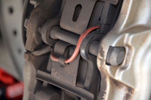

My front 2005 CS brakes will need replacing soon. Has anyone tried the "PowerStop Brake Kit" yet? Online its going for $291.67. Seems like a good value. My concern is disk warpage over time. I've read many posts here and am still tempted to order the PowerStop Kit. Other alternative I am thinking of is Hawk Performance Ceramic pads (as per a post). Hawk Quiet Slot rotors look interesting too. I think EBC YellowStuff will be too much for my regular everyday communting. I actually don't like the "quick bite" that my current pads have.
Thanks in advance for your advice.
post-88071-0-49257100-1369281572_thumb.j
post-88071-0-68116200-1369281575_thumb.j
post-88071-0-49760700-1369281579_thumb.j
ps. Was asking the Porsche parts guy whether or not the OEM brake pads comes with "anti squeak" compound... he confidently said "don't need it". My brakes sqeak.
