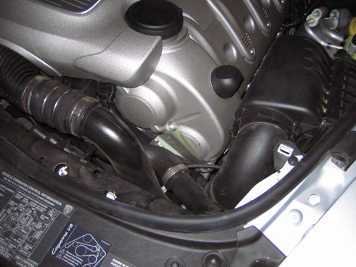

does anyone know how to install the aftermarket air filters for a cayenne turbo?
I see the spring clips on the top but something is holding the rest of the housing on the bottom.
I found a DIY here at renntech, but it's for the Cayenne S. The piping on the turbo is different since the S' intake goes directly to the throttle body.
I can't seem to be able to get the housing lid to come up and off.

So I gave the dealer a call.
fairly basic...
1. remove all pastic trim pieces around the engine bay via 1/4 turn screws (watch out the pop out sometimes), you'll notice the air filter housings on both sides.
2. start with the driver's side and look for the 2 plastic torx screws (T27) on the lids of the housing.
3. Look closely and you'll notice the head of the torx screw is not round. it was a small extension protruding form the circumference of it.
4. look even closer and you'll nitice a black dot debossed from the housing around the head of the torx screw.
5. line those 2 up and give it a pull and the whole pin will come up.
6. undo the 2 metal spring clips and you'll be able to pull the lid completely off.
7. replace the filter and repeat steps for the otherside.
8. However, there is 1 extra step on the passenger side that needs to be taken.
you'll notice a vacum tube in the rear bottom of the lid that needs to be removed first. It's a *****, but it does come out. don't forget to out it back in when you are done changing filters.
9. all done. :thumbup:
