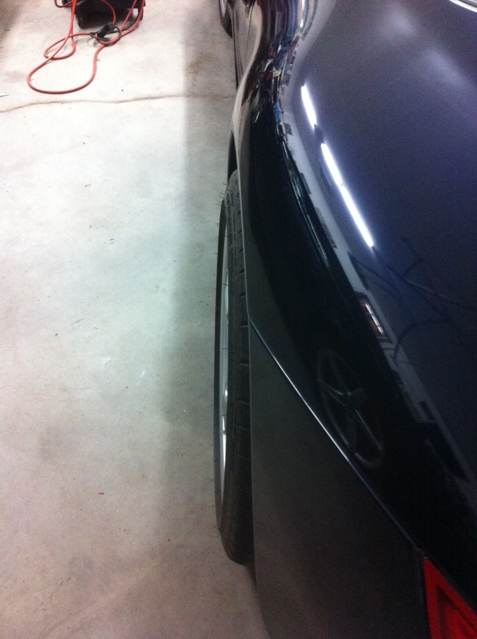

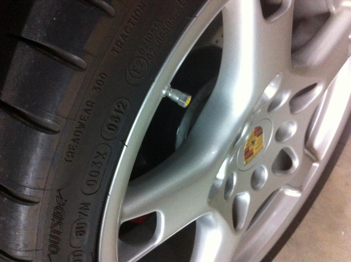

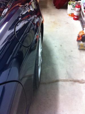

Here are some pics. This is a 2006 2CS
Top left-rear profile, no rubbing since installed 3 years ago. 305's
Top right-front spacer
Bottom left-rear spacer
Bottom right-front profile

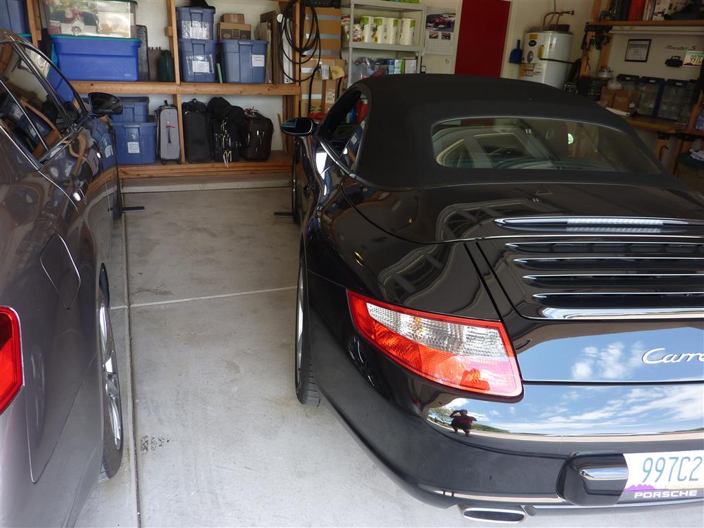

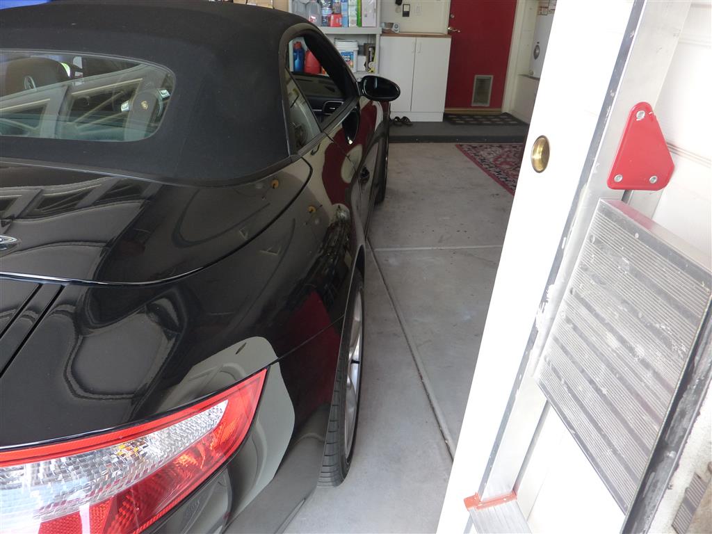

Installed the spacers today, 7mm on the frone and 15mm on the rears. I think that I made the right coice and welcome input. Pretty hot out there today; 105 and I'm glad that there were only 4 wheels to do. Got pretty tired by the end.
