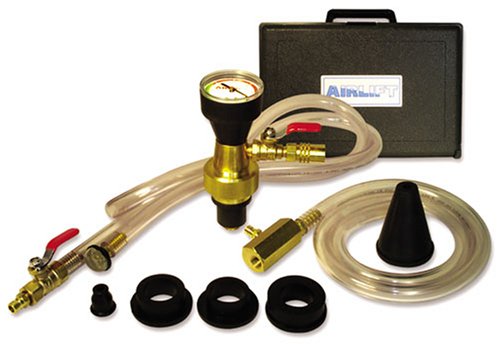

Take your time in taking air out of the system if you are not using a vacuum pump. A trick is to park the car on an incline, front end towards the bottom, and open the expansion tank for a while so all air bubbles come out.
