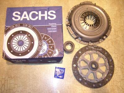

The clutch I got from ebay which Toolpants posted is NOT right for my '97. I will post the photos with the differences. Had to get a clutch ordered. Don mentioned that the first clutch he ordered was the same. He had to provide them with my VIN# to get the right one. So there were changes between the '97 and '99. You have to be careful.
The right part# 986-116-911-01
The SACH reference on the box: KPR91601 which didn't fit my car.
