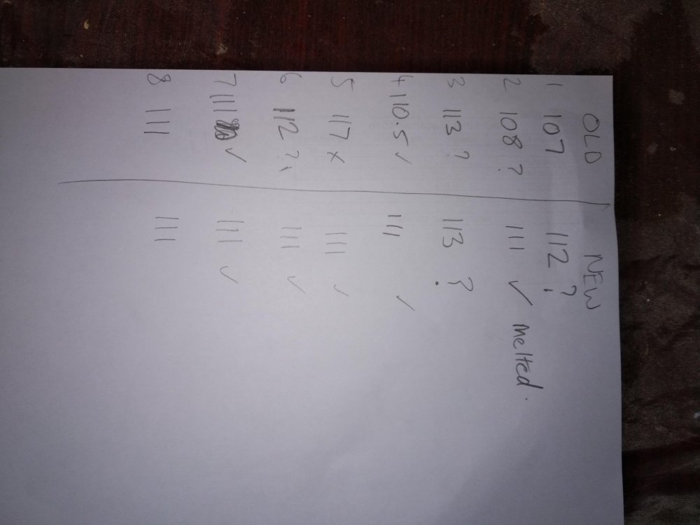

Just to update this post, the new fuel pump left and the right side did NOT fix the hesitation and stutter. It always comes back when hot and heat soaked running.
I have recently suspected the newer coils (fitted 8months ago and 10k km) may have some issues. When I installed the old cracked coils the problem was the same symptoms but just worse misfire under load. Testing them for resistance across pin 1&3 gave the attached ohms reading and newer coils 1 2 & 3 are suspect for hight ohms and 2 is melted on pin, as per picture.
I now intend to replace 123 coils and retest.
