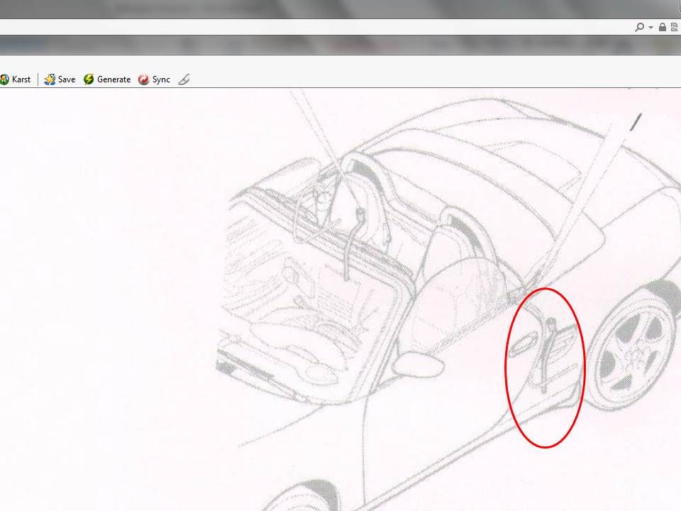

check the rain drain's blow them clear, also check the alarm computer under the drivers seat. mine got damp and the immobilizer quit car didn't want to start, starter didn't engage. if the windows go down by them self and or alarm goes off. It may be to late.
Most likely your drain behind the driver's seat. Check out this helpful link on Mike Focke's site below:
Click HERE:
Scroll down and read entire page. Use the suggested method of pouring water down and catch it in the drain in front of rear tire to see if you catch it all.
Here is the drain that is most likely the problem:
