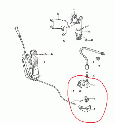

You can start in the engine compartment where the cable is attached to the throttle body and then go under the car where there is a junction that guides the cable at a right angle towards the front of the car. The junction is in a small black plastic housing under the car, just forward of the front of the engine. You can undo the cable from the throttle body and also take the junction apart to get the most lube in there. While you are at it, inspect the cable at the junction to make sure it hasn't slipped off the "wheel" guide you will find there.
Here is the area of the junction, to help you locate it:

You would be amazed at the difference after lubricating the cable.
