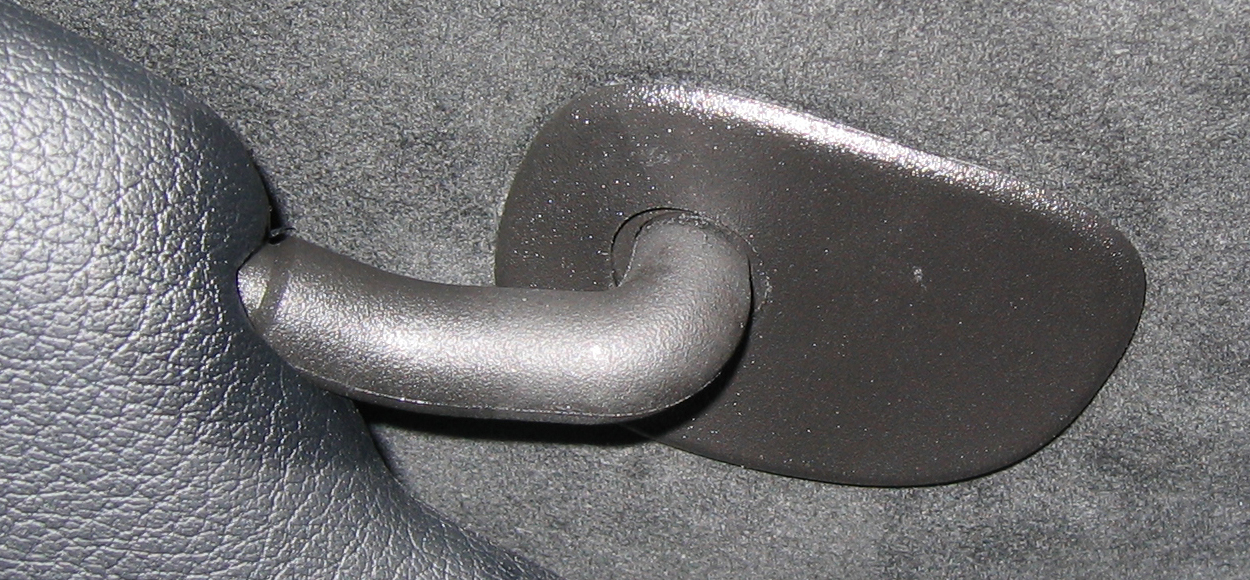

Loren - not at all like my Boxster. On the outer side, it looks like the visor post comes down from a round fitting, without any little flip-up cover. On the side closer to the rear view mirror, it comes out and swivels to the side windows like a regular car, not fixed like on my Boxster. I don't know anything about 996s, so can't compare to one of those

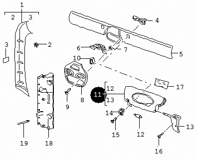

Should pull off. Parts are 996 parts according to the 997 parts list.
Thanks, Loren! I tried pulling on it last night when I snapped the picture, but it didn't come out (easily). Pull harder? Does it need a specific orientation to release?
1. Put the visor down and release it from the clip near the rear view mirror.
2. Gently wiggle it back and forth as you pull it towards the center of the car.
About a 5 second job.
Loren,
That did the trick. One good yank loosened the visor enough to pull it the rest of the way out. Thanks
