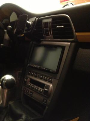

I have the Bose system in my car and installed an Alpine INE W927 HD along with the NAV TV unit. The sound is way better and now I have the best Nav, Bluetooth for the phone and flawless iPod integration. The system has been in the car for a year and has not sneezed once.
post-89070-0-49762100-1383510577_thumb.j
