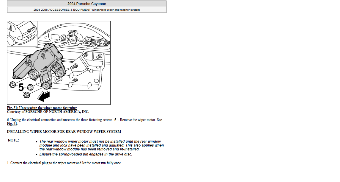

I need to replace faulty rear wiper motor. Can anybody advice how to remove wiper cover? Manual refers to:
"70 87 19 Removing and installing lining for rear lid as MY 2003" which I can not find.

thanks for the drawings. I have instruction how to remove a motor itself. I do not know how to remove a inner lining from rear hatch to unveil the motor. Everything looks so solid so I do not want to break any plactic clip.
