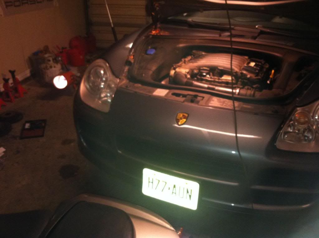

Pics of my night...
My babies outside in the cold :( - Cayenne is in the garage under investigation.

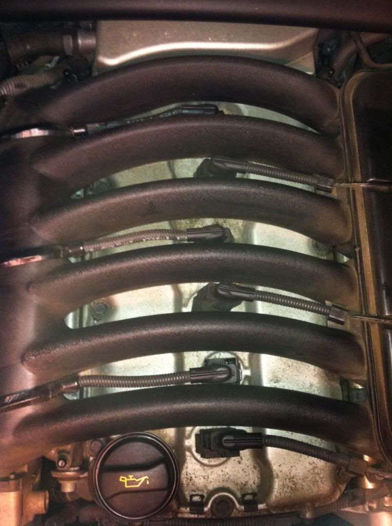

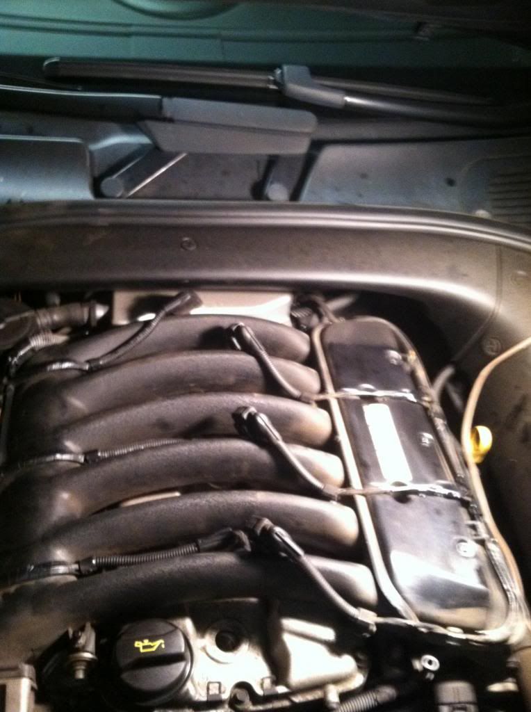

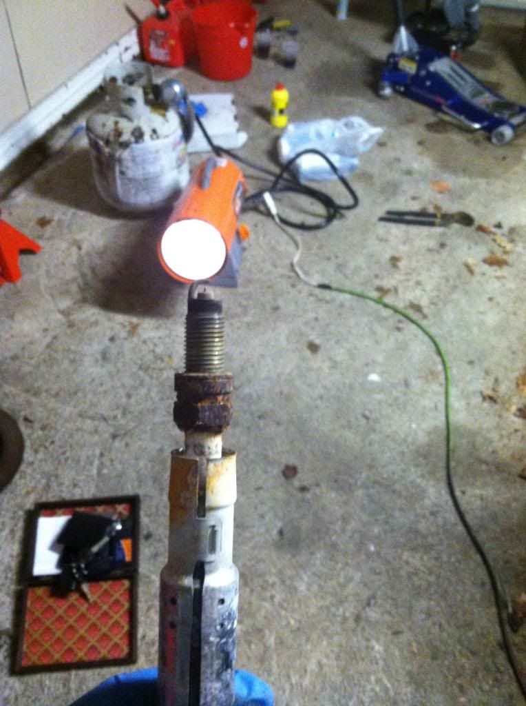

-removed the plastic cover

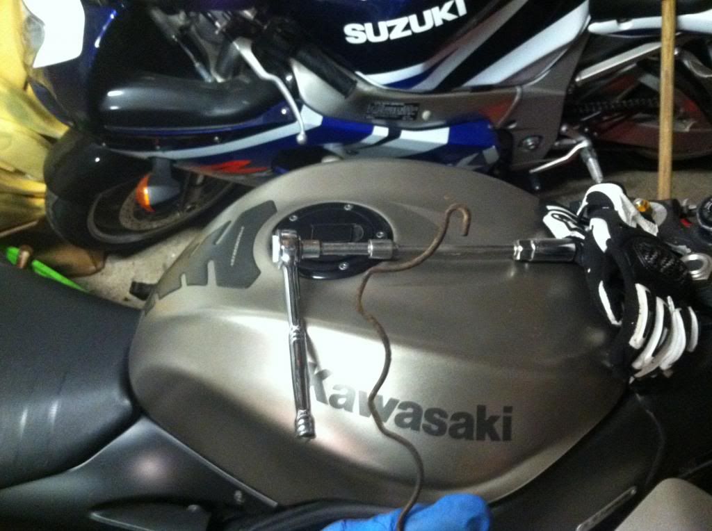

-pulled off all the coil pack connectors using a tool i devised (bent wire)
-unbolted all of the spark plugs using a 16mm socket with about a 12" extension

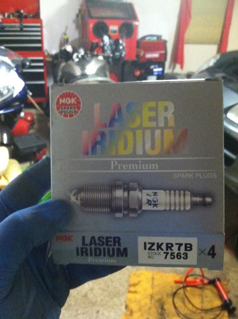

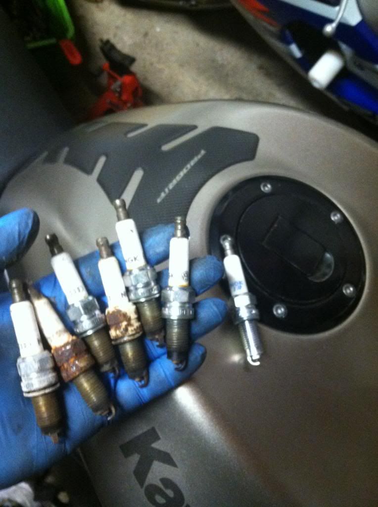

New Spark Plugs OEM NGK's
Looks Like someone has been in there before me..

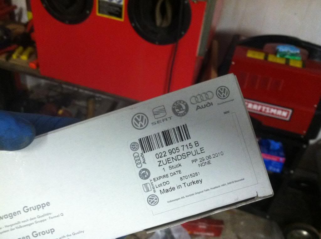

coil pack 1 &2 from the left are from the car the 1st one on the left is the original VW part # 022 905 100L while the middle and the one on the right (new coil pack) are new VW part #'s 022 905 715B. Old coil packs are showing alot of wear as well as the spark plugs
