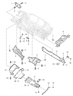

Looking for a replacement splash pan for my 2008 Cayenne Turbo.
Would not like to go back to the dealer/stealer for these parts.
Ahspros
If you have option codes: I6EA, I6EQ, I6ET
(without additional body covers, stone guards type 2 or 4)
then use: 955-504-285-02 Under-body protection, front -- US MSRP $113.31
If you have option codes: I6EP, I6ES, I6GE, I6GF
(with additional body covers, stone guards type 1 or 3, wider wheel arch covers)
then use: 955-504-235-02 Under-body protection, front -- US MSRP $276.57
If you are not sure PM me your VIN and I will check for you.
Thanks for the VIN - here is the correct part for your car (by VIN).
