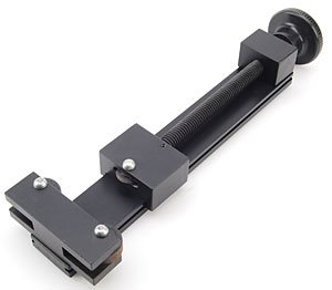

I just ordered the Proform oil filter cutter from Summit for $75.97. Too bad i have another 2100 miles to go before i get to use the new tool.
Here are the vitals from summit web site...
Manufacturer's Part Number:66490
Part Type:Oil Filter Cutters
Summit Racing Part Number:PRO-66490
UPC:037995364909
Cutter Material:Billet aluminum
Cutter Finish:Red anodized
Quantity:Sold individually.
In-Store Pickup:Choose In-store pick-up (OH, GA, NV) on our web site.
This one is by Proform, and my personal favorite because all of the cutting wheels and bearings are replaceable:
