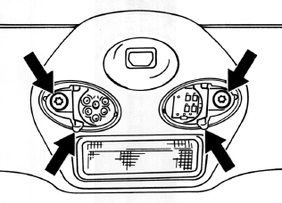

I had a similar issue, after checking the codes it turned out to be the interior infrared sensor fault above the rearview center mirror. It gets activated when you lock your car and the "Red Clip" is used when the top is down or the top is up and the micro switch is activated. I ended up replacing mine and the problem was solved. . Check your codes and see if you get a "Fault 34" Passenger compartment monitoring sensor. Simple DIY. The arrows point to a Torx T-30 fastening screw that holds the sensor in place, The sensors and screws are covered by two smoke or black covered oval lenses that just pry out. careful their plastic.
The part is about $80 or so.
