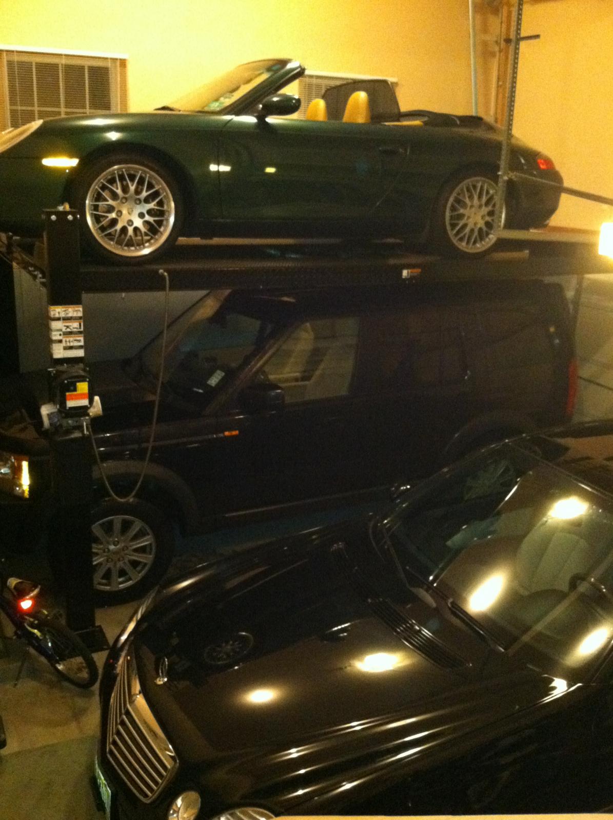

As someone that owns both two and four post lifts, I can tell you that a two post offers better access for service and maintenance purposes, but can often be impractical in a residential garage as the two post have to sit several feet outboard of the car's space, which can be space prohibitive in many home garage areas:
Two post lifts also typically require a minimum of four inch thick floors (rebar reinforced preferred), which is usually more than you would find in a home garage. Your floor can be cut and modified to accomplished this, but it will add cost. You also have the overhead clearance to be concerned about, so check with your proposed lift vendor to be sure the two post will actually fit.
Four post lifts are much narrower and can fit in lower ceiling garages, and can be adapted to handle most service tasks. Because the four post literally "sit on the floor", most home garage floors can easily accommodate them without modifications:
Unless your garage can handle the two post, you may be way ahead in both the grief and bucks departments to consider a four post.

For my four post lift, the bridge jacks were a must have, IMO. Make sure they are converted to pneumatic so you can power them with your air compressor or you wear your arm out pumping them up. Get two and you can lift the entire car and remove the wheels for maintenance. You would be hard-pressed, I think to drop an engine or transmission with the four post but you can do most normal type work. I store a 996 Turbo above and a 944 Turbo S underneath. The Vette or the 911 Convertible get the single space during summer months. It's hard for me to imagine not having made the decision to make the purchase. It makes cleaning and polishing so much easier on this old body. Sitting or standing is preferrable to crawling on the ground, lol.
