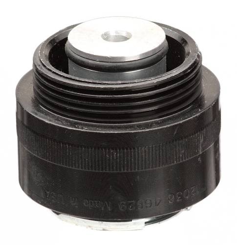

Stant makes such an adaptor, but it is listed as for VW. He definitely needs to pressure test the system.
So just to confirm, you're saying Stant makes an adapter to test the cap? There are plenty of alternatives for adapters to test the system.
Yes, but it was listed in their system as for a VW/Audi (now corrected), which makes sense as the two vehicle's share a lot of components. We found out about it because we had one and noticed it fit and worked perfectly.
Pressure Tester Adapter Type: Radiator cap 12037

They also have the other side (12036) which is the system test adaptor:
Both of these were listed for years as covering mid sized Audi and many VW models, but they both work on the Cayenne.
