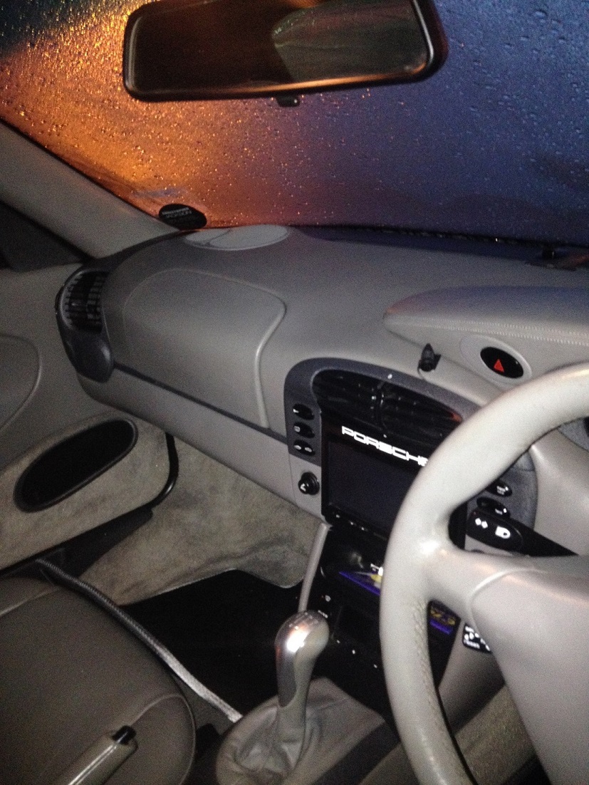

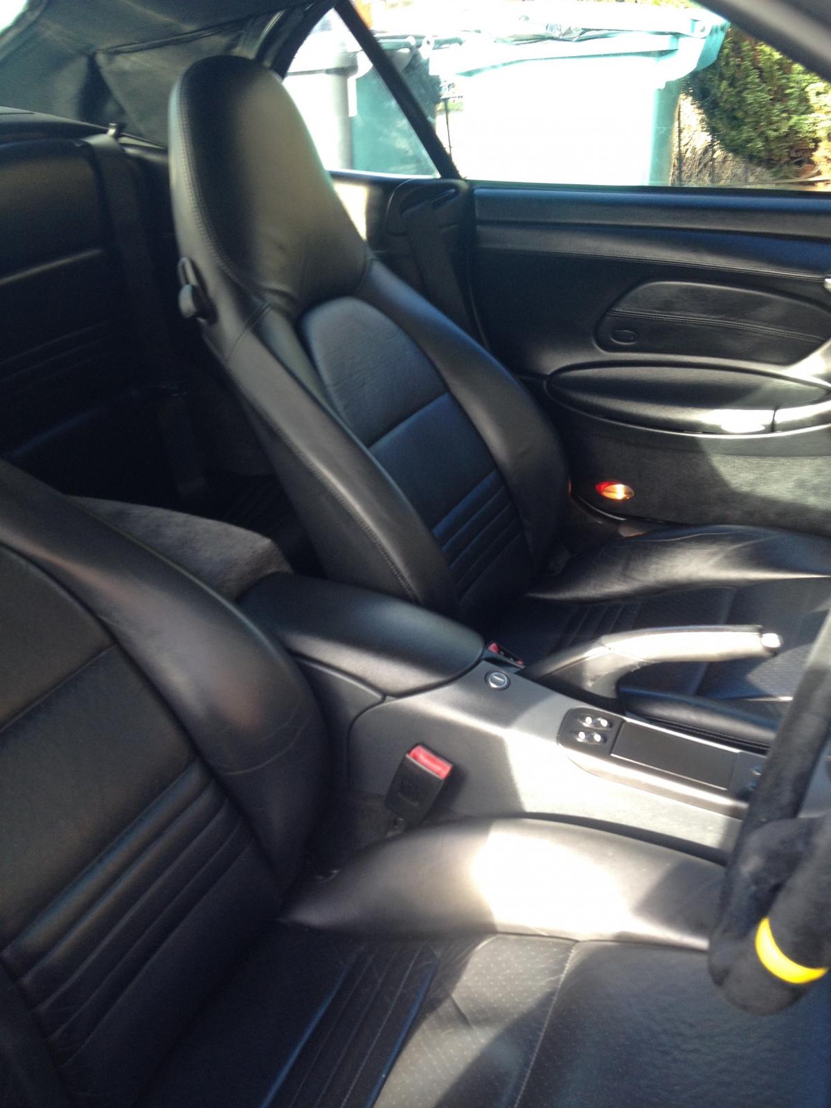

Thanks, Im very happy with it. There were lots of loose screws etc which explains the rattles, Now all gone. Carpets were soaked due to blocked drains, Again all gone. Changed the dash bulbs to red for the bottom of cluster and blue for clocks and looks more modern now. Fitted some wheel spacers aswell and had coilovers put on a few weeks ago. New indicator stalk which fixed the not working self cancelling indicator issue. Next stop, GT3 bumper and skirts.
Nice work. Can you expand on what seats you used (997?) and whether resurfaced or replaced door panel, etc. what kind of sound insulation did you use( can't recognize logo) and why did you go the extra mile with the insulation?- new sound system,Peeved with rear tire road noise ?..?

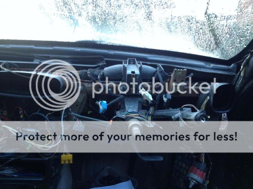

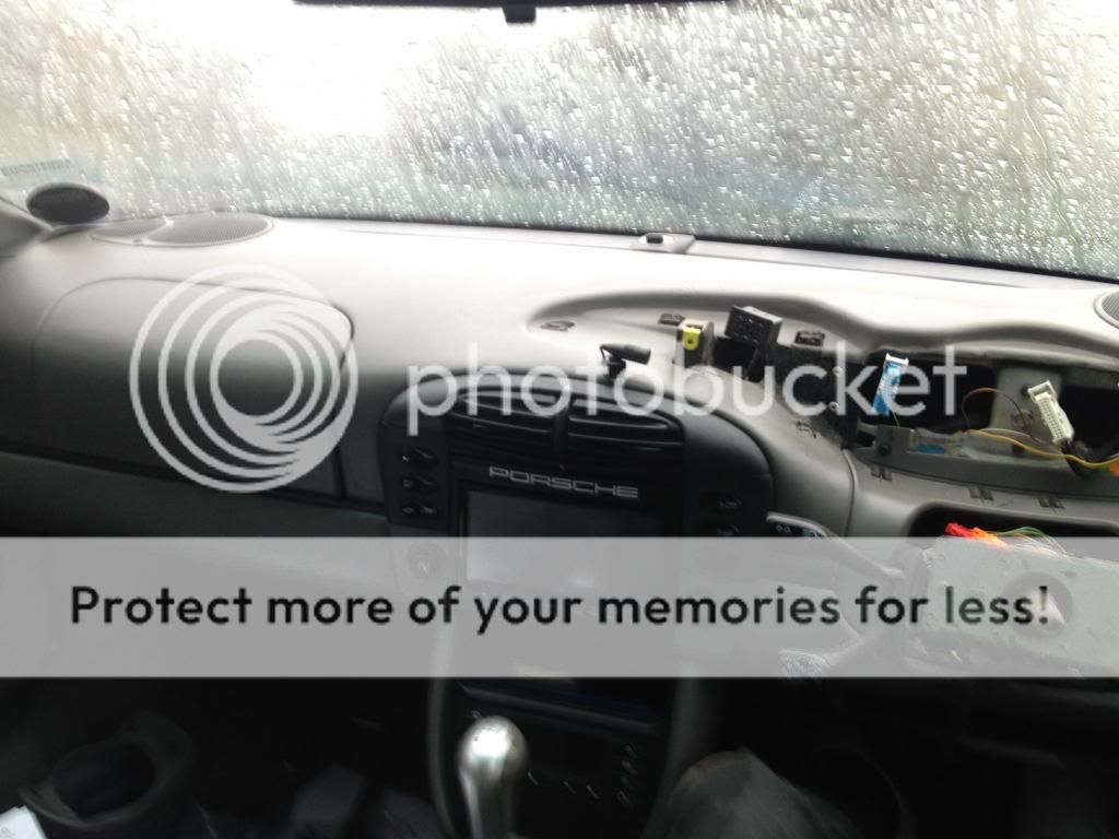

Hi,
Seats are from a low mileage 2004 boxster and are mint condition, Door panels i bought in seperate auctions for about $90 each. Rear panels and seat cushions were dyed with leather dye and look brand new. Dash was from a 996 and was only about $150 and in great condition. All other bits and bobs bought on ebay for small money. Regarding the Fatmat sound proofing, I felt the car was too noisy at motorway speeds and wanted to quiet it down a bit which i think i have although if someone has a cab and the iphone decibel app then it would be interesting to test at 70 mph to see what the difference would be. Best thing is i think i have put the car together much better as there are no rattles or squeeks like before. Also had coilovers fitted and wheels spacers which make the car look and drive much better than before probably due to tired shocks etc.
