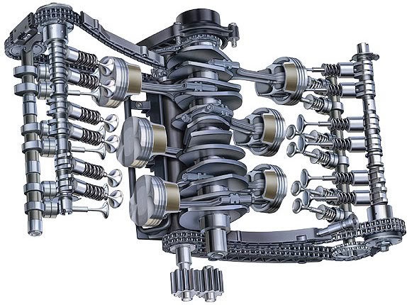

Let's try to confirm the following and see if I missed anything:
1) LN tool is meant to lock bank1 regardless of 3-chain or 5-chain engine <- confirmed by JFP on your other thread on LN IMSB instruction
2) The half-moon orientation needed before you insert the tool on bank 1 <- confirmed by xmac on 5-chain engine (larger half moon closer to engine block and smaller half moon closer to camcover)
With both of the above you cannot insert the LN tool to bank1 regardless of which TDC. That sounds like a problem by itself since you can't poceed without locking bank1.
Regarding TDC definition, I'm not sure either but if the engine is at TDC (about to ignite) on cyl #1, the valves of cyl #2 and cyl3 are FULLY open, which will exert a lot of force on the camshafts (tend to rotate the cams) and the IMSB side since cyl3 is closest to the IMSB.
On the contratry, if TDC (about to intake) on cyl #1, only valves on #5 and #6 are FULLY open, which will exert less force on the IMSB being far from it. Even though in both cases cams in bank1 will be locked anyway, the latter seems to create less stress to the locking tool hence a safer position and less tendency to rotate.
I believe that both of above are correct.
I have only tried to install LN tool to bank 1 once, it might very well go easier to my cams if I rotate another 719 - 720 degrees, getting the lock installed requires some finesse on turning the crank.
Yes, compression TDC #1 will have stress on bank 1 as then there are two valves open on bank 1. Overlap TDC #1 on the other hand means there are no valves open on bank 1.
